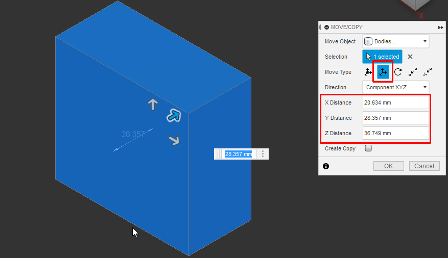

Ideally each part would be a component and you'd position with a joint. If you want to stick with using bodies then use a translate, not a free move and then edit the move, don't keep creating new ones.
As you can see translate keeps a record of the position.
