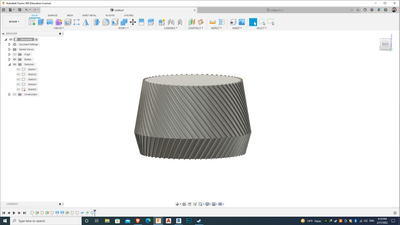

My result:
However, the patern I'm looking for to design looks more like this:
As you can see my patern has 2 directions. Can anyone point me in the right direction?
Thanks a lot!

Hi @aliobidi, can you elaborate a bit what you're doing in sketch 4?
It looks very promising and I already altered your design to what I want but I want to understand it a bit more.
aliobidi
in sketch 4 ..I use  project tool as you see it in the Pic
and in sketch 5 .. I project sketch 4 lines to surface this tool called  "  project to surface" as you see in the Pic
vanwolleghempiet
@aliobidi thanks for this insight. Didn't know this feature but it solves my issue and I'll experiment a bit.
