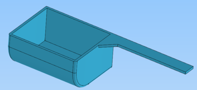

I need two plate mould with stripper ejection help me please u may understand my intention .
Please....
I would probably add some draft (release angle) to the original part.
Of course  you will need to show what you have done so far to get additional help.

FacebookGroupMember
https://a360.co/3kOg4nw
Now can u help me runner and gate

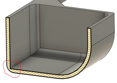

TheCADWhisperer
Has your instructor taught how to use Fusion 360?
Sketch1 does not have any dimensions?
There is (almost) never any need to use a Move command.
Sketch2 is empty?
Shell done at the wrong time (before Fillets).
Sketch3 is empty?
Sketch4 does not have any dimensions?
Sketch5 is not fully defined?
Another unnecessary Move?
An incorrect Fillet that results in very thin corners?
...and doesn't match the drawing?

sir now i given edge radius

TheCADWhisperer
Message 19 of 21
FacebookGroupMember
Each edge radius 2 mm
Message 20 of 21
FacebookGroupMember
There is no radius
