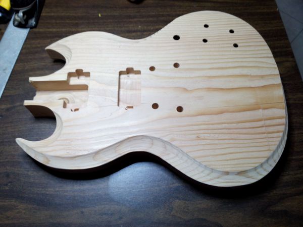

In my past guitar making, I’ve always only done completely flat-slab type designs, because it was relatively easy to cut out the shape on a bandsaw from a flat chunk of wood.  But, I’ve always wanted to do a carved top guitar.  I realized that the combination of 3D design in Fusion + CNC for manufacturing would give me a powerful way to explore this type of design.  We are also working on a hollow-body version, which we think will further illustrate the power of CNC + 3D modeling.
We learned a lot.  We made a lot of mistakes along the way:  Everything from mis-measurements of the neck and bridge positions and height to tool path errors to simple human mis-communication of who was making which changes in which order.  We made lots of test runs using cheap wood, each of which revealed things we hadn’t thought of (for instance, that the mounting screws for the bridge can’t go into the control cavity!).  However, we are very happy with the results.  The Fusion model, I think, came out pretty cleanly.  It is fully parametric, and can withstand customization of the outside shape, the carved top shape, etc., and updates without errors.

An early test run using glued-up cheap Home Depot pine:
After milling:
