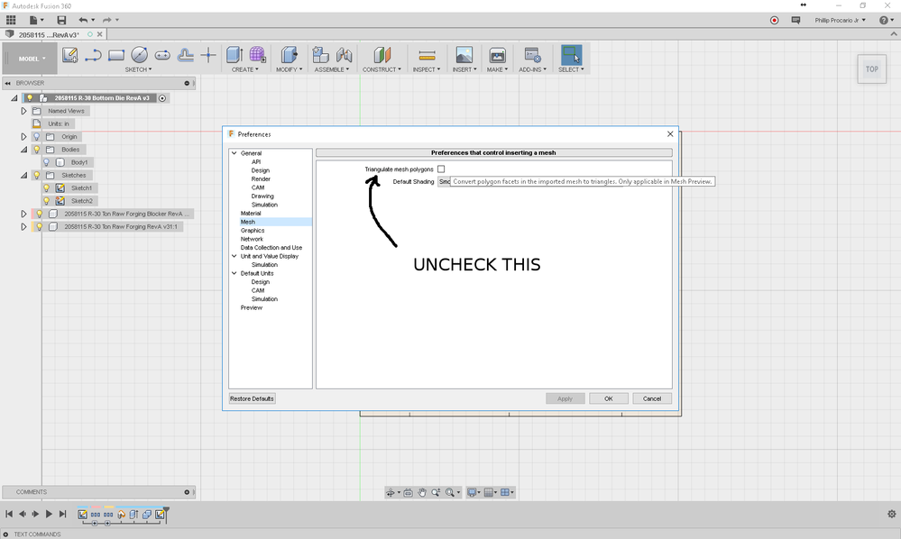

PhilProcarioJr
@Anonymous
Click your name in the upper right corner and select preferences, then uncheck auto triangulate meshes on import.Untitled.png

@Anonymous
Hi there - I am a ReMake user myself.
I assume based on what you said sofar you exported from ReMake with Quadmesh export OBJ for Fusion 360. Right?
You imported a triangulated version into Fusion as evident in your screenshot.
As @PhilProcarioJr  stated there is an option in preferences to turn auto tessellation off.
When working with T-Splines you really only want to work with Quads. Currently it has problems dealing with triangle and ngon faces.
Let us know how things work out.

Message 8 of 9
Hey man thats it!!! This was the magic :-))))) I DO NOT LIKE CHECK BUTTONS 🙂
Message 9 of 9
Perfect your solution works cool and this guy Philprocario fix the problem with the triangulars 🙂
