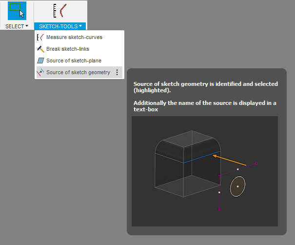

Update available: Version 1.1.0, 4/29/2019
- Command added: "Source of sketch geometry"
- Toolbar customizations ("Pin to toolbar") are saved
Download from Autodesk App Store
Support Page
