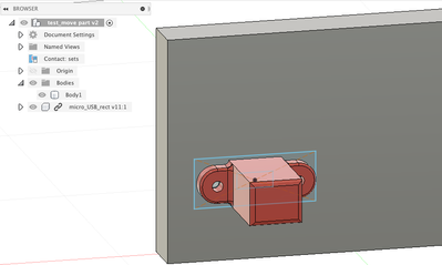

I have a design with two components: a panel and a connector. The connector mounts on one side of the panel. I need to transfer the drill hole locations to the panel. I also want to extrude the rectangular shape drawn on the front face of the connector into the panel to thin the panel where the connector will be placed.
I can get an extrusions through the panel and to a depth in the panel to work to work. (Only the holes have been extruded in the included figures.)
The connector will likely have to moved because of other considerations. When I move the connector, the extruded features remain in their original location.
How can insure that the extrusions move with the connector?

1. create a new empty component for the wall and make sure it's activated. (by default it should be)
2. Ground the component
2. Create a sketch, extrude it to create the 3D geomerty for the wall.
Insert the connector and use an assembly joint to joint it to the wall at the location and depth you want it in your fnal model ...

You should be able to follow the Timeline in the file that I attached, but I would have done it slightly different creating a New Component for the Connector and a New Component for the Panel before ever creating that geometry.

Here is a summary of the solution:
1) Create a panel object and fix it.
2) Include the connector object.
3) Use the join command to place the connector on or in the panel.
4) Create a sketch in a plane parallel the end of the connector. Project any features needed from the connector such as mounting holes. Add other features such as cutout clearance around the connector.
5) Extrude the sketch features into or through the panel as required.
6) To move the connector, edit the join command in the timeline. The extruded features will move with the connector.
