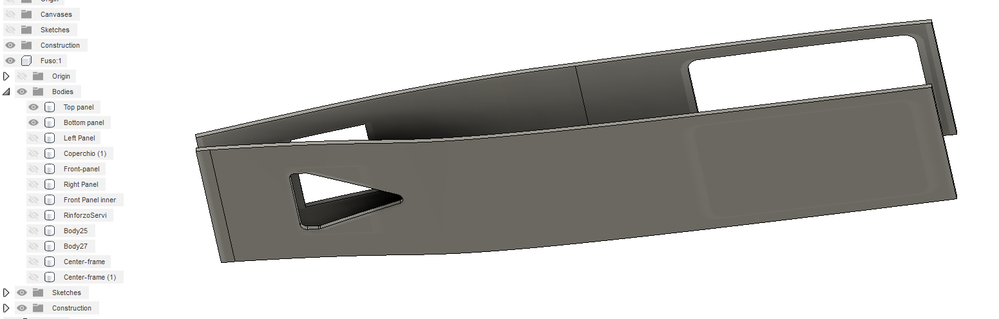

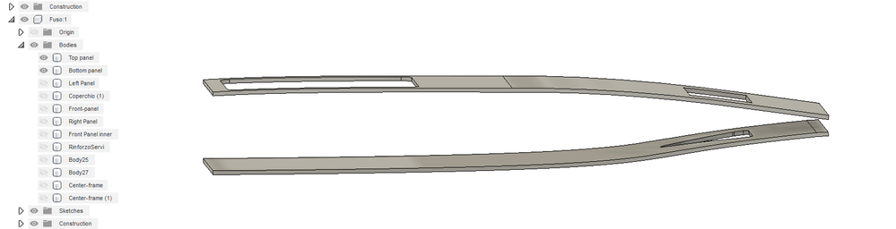

I modeled a fuselage in design. It has lateral panels that are flat and top and bottom derived from an airfoil  and then completed with spline. All panels are bodies inside a component.
I need to flatten these top and bottom curved bodies so I can profile-cut them in CAM.
I searched and tried some solutions that pass trough sheet metal without success.
Could you point  me to some solution?
ThanksTwo panelsTwo panelsbottom viewbottom viewtop viewtop view

pietro.rossin
Thanks for help, here is the file.
I'm a hobbist, not engineer.. So don't be cruel 😉

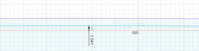

First thing I wonder about when I see something like this is, "What is the manufacturing/design tolerance?"
You have a curve that is close to horizontal, but not quite a simple horizontal line.
Now, if it has to be as it is, it has to be as it is...
But, if it can be a horizontal line...

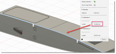

g-andresen
 just take the stretched length with the measuring tool > done.

pietro.rossin
Is this sketch5? It could be flat indeed but as I said I'm not an engineer, and I didn't imagine that I went across troubles sketching this way.

g-andresen
Such a profile with a thickness 1,6 mm is glued to the side panels without prior bending. So take the stretched length and the width of 50 mm, cut out the triangle.
günther

Follow the path I have described above.
1. create a blank with the plate (1,6mm) with the length (measured stretched length) and the width (50mm)
2. if it is to be made with CNC, put the sketch for the desired cut-outs on this plate and generate the necessary tool paths for the machining.
With all due respect, this is as shooting at sparrows with a cannon.
