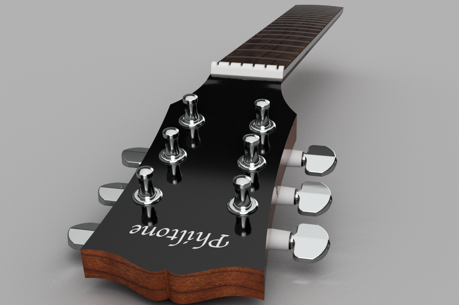

I've been doing some workflow testing on the next release. I picked what I thought would be an easier guitar, my ES-335, and if you know these pretty babies you know they have a slight dome to the top and bottom faces which I will solve using Edit Face if at all possible (once I get there). Modeling guitars is an art, I'm learning.
I just finished the neck/headstock down to 12th fret. Philtone is my brand, for better or worse. 🙂
Thanks guys, I'm avidly following this conversation too!
PS: I found some excellent Gibson spec drawings with a little google searching... 😉
