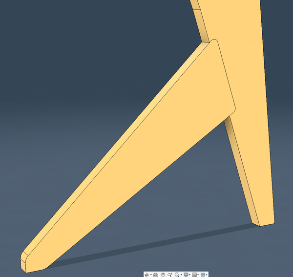

Hello, I have encountered an annoying issue with filleting and could not solve it using fillet with rules or tweaking the sketch. before I go around creating a very convoluted workflow/hack, I though Iยดd ask the wiser here.
I am creating a piece of furniture and have two bodies that will come together to for a set of legs. They are separate pieces but get finished together. In this case, a round over.
one of the pieces however gets all of its edges selected when filleting. this produces a result that is far from what I am trying to achieve as the roundover should follow the design of both pieces together and not each individually. Moreover, I do not want to fillet where the leg touches the floor. There are vertices on the sketch in both points but it seems that fusion sees them as a seamless form and ignores any break, point or vertice I would expect to use as a "stop" point.
Images below.
Thank you for your wisdom ๐Ÿ™‚

I am not totally sure how you want the fillet applied to the gray piece, I just guessed, but the wood colored piece I am sure you are looking to "uncheck" the Tangent Chain option when you select the path.  This will allow you to just select the edges you want.  Although a faster way is to leave it on, let it select all the edges and then use the "Ctrl" (on Windows) "Command" (on MAC) and deselect the edges you do not want.  My guess of the model is attached.

Thanks @jhackney1972 , deselecting tangent chain helped. It solved the problem at the foot level.
At the joint between the two parts I am starting to think that the problem may not be easily solvable or possible.
I am trying to do the round over right after I create the component and while it makes sense from a digital workflow perspective, they are two bodies and I need to round them over as one.
An alternative would be to follow a production line approach and have a "finishing" routine at the end of my project where I combine join the two pieces (equal to glueing them in the real world) and THEN round them over as one (as I will in the real world). The problem then is that if I combine them I am creating a new, solid body and the joinery and wood direction are lost.
The closest to doing this I can imagine would be to create a rigid group and be able to fillet that as one. I do not think this is possible.
For the record I was able to get close to the visual result by using a combination of split -patch - split but it has left issues that do not allow me to easily recombine things as one. Moreover, this looks like an ugly workaround so not keen on stating this as a good solution.
I am uploading this experiment. take a look at where little (right) leg meets big leg. My patch job is on the top bit of the joinery.

@relopesfusion0 Now that I know how to model this, I am wondering how you propose to manufacture this. Using the patch tool - and most definitely the way you used the patch tool - will not create geometry accurately reflcting an edge created with a round-over bit.
This is much more manufacturable and the radii with the arrows should be at minimum be the radius of the bearing of the round over bit, ideally a bit larger.

relopesfusion0
hey @matthewZYM62 I like this!
it is close to what would happen in the workshop, with a final pass on the router with a round-over bit.
I would have to have multiple paths with multiple profiles if the passes are not continuous (so to not round over the feet for example).
it also highlights a real life issue, in which it is not easily doing smooth cornering. In real life I may need to leave some additional material to be removed with the router so to have a smooth transition from the small leg to the big one.
All said, it respects the parts as separate entities.
