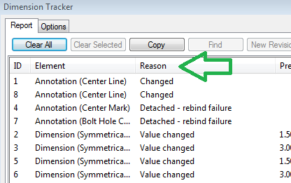

Also I suggest that there's an option for the user to manually apply the auto update as it'll give the user an idea what has shifted/changed/broken. SolidEdge has something like this (image taken from http://www.designfusion.ca/designfusion_blog/how-to-reattach-a-bolt-circle-and-its-dependent-dimensi...
I hope Autodesk takes the implementation of drawings seriously and to my understanding some features that is requested do sound unnecessary for hobbyist but it's crucial for those people who are paying for Ultimate, so I guess some of those features could be for Ultimate only, something like Advance Drawings or something.
