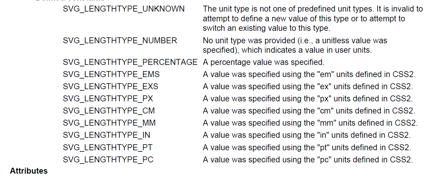

HughesTooling
SVG can have different scale\units it would all depend on the program the file came from, can you upload a small sample file.
Here some info on different unit types for SVG files.
