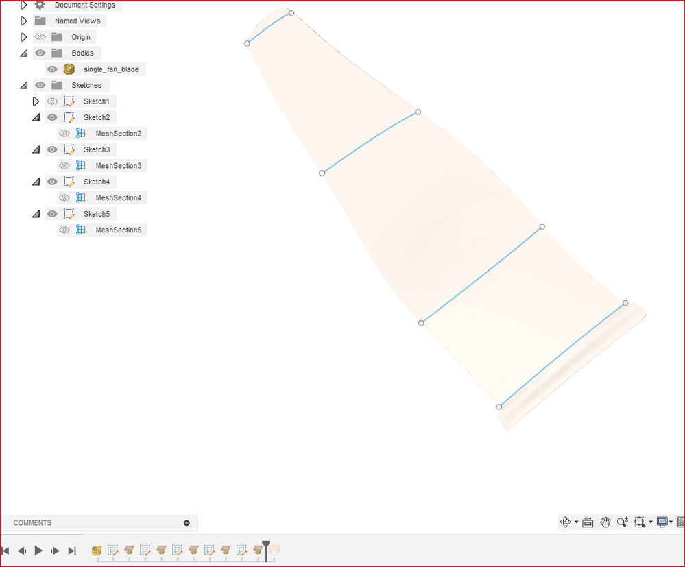

davebYYPCU
Create > Mesh Section Sketch.  Moving the selection marker to where you may need it.
Do not use Fit Curves to sketch, because the default curves' curve comb is atrocious.
When you have these sketches created, you can place 2 point splines as chord curves.  3d sketch and snap splines to the spline points.
I agree that the rail curves will be needed for Loft control.
3d Spline handles can only be edited / moved with Move Tool.  (Splines will turn blue)
Might help...

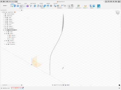

Drewpan
Hi All,
Ok. Making some progress. I have managed to get something fairly close to the leading edge curve.
My trailing edge is way out. I have used the intersecting surface method. The mistake I had made
was trying to intersect surfaces and not change them into bodies with thickness first. Still a bit of
a work in progress. I will let you know how I am going. Used the wrong surface for the trailing edge
so will re-do it.

Message 14 of 29
davebYYPCU
The mistake I had made was trying to intersect surfaces and not change them into bodies with thickness first.
No, that would be another mistake.
Develope the surfaces and use them to Surface > Modify > Trim each other.
Trim will remove the offcut, and you will only need one body (front / back) to reference when done.
Much simpler to snap splines to 4 end points and then manipulate the handles.
I found the file confusing as the midpoint of the flat stand is not close to the Origin, in 2 directions.
Flush with and around the Origin, makes Offset planes easy to understand the geometry.
Not obvious question, are the (airfoils) profiles in the STL, the ones you want to use?
Might help...

Hi All,
Continuing to make very slow progress on this. Have a quite odd issue right now
using intersecting surfaces method. Both surfaces are at right angles to each
other. When I thicken them up to 0.001mm and try to create the curve with a
combine cut intersection, what I get is a body that I can use as a rail, but there
is a strange artefact on it.
As you can see from the shadow - what is this ribbon hanging off of the rail?
This is not a graphics issue, the software has calculated it as there. The combine
cut intersect should not logically create it.
I have thickened the surfaces to 0.01mm and it disappears.
Any thoughts?
Otherwise I am crawling forward but haven't cracked it quite yet due to having
lost time making modifications to the wing.
Cheers
Andrew

Message 19 of 29
laughingcreek
@Drewpan wrote:... Both surfaces are at right angles to each
is a strange artefact on it.......
thickening up your surfaces by minute amounts is your problem.  this isn't how the intersecting surface's technique works.  you just create surfaces, and then use the edge of a resulting surface for your rail.

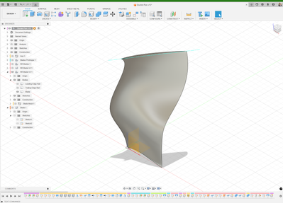

Hi All,
Success.
Prototype 3d printed fairly well of the RR Blade shown here. As you
can see in the Browser Tree I had a few practices before I got to this
point.
Next step is create a custom 3D leading and trailing edge from what
I have learned here, replace the airfoils with what the guy wants then
mount them onto the hub. I just hope that when I do a few cross check
calculations that the tips will not melt or explode when the balanced
titanium version spins at 20,000rpm. In a DUCTED FAN! I thought that
only turbines went that fast but he insists he has the appropriate fan
motor ready to go. The blades are 140mm so the fan will be about 300mm
when done.
Thank you so much for your help guys. I have learned a great deal about
fusion and practical engineering with this project. I will let you know how
it goes when I find out.
Cheers
