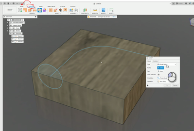

This may be a simple solution, but I am very new to fusion (coming from autocad and sketchup) and I cannot figure out how, and not sure the fusion terms to be able to search for an answer.
How do you carve/cut a sketch along a path on a body?
I am attempting to add the U shaped channel like in the attached image. I can create the path I need to follow as a sketch on hte top face and create the radius circle I need to follow it with on the vertical face. But cannot work out how to 'carve' the radius by following the path with it.

The command you will use is called "Sweep".  It requires two sketches, one of the profile you want to cut and one of the path you want to cut along.

I must be doing something wrong with my path and profile sketches ,perhaps? They are both drawn on the surface I need them to be (path on top face, circle on side face).
Testing it out on a simple test object gives me this.
I only get "new body" and "new component" as my drop down options. As it makes a new solid body vs a cut.

Attach your model, I will help you out.  If you do not know how to attach your Fusion 360 model follow these easy steps. Open the model in Fusion 360, select the File menu, then Export and save as a F3D or F3Z file to your hard drive. Then use the Attachments section, of a forum post, to attach it.
Edit: Just a guess, you are not selecting the entire circle as your Profile.

And I very much appreciate the help. I was trying to work it out on my own, even tried the sweep tool before but got the same results I have this time. So figured it must not be the tool I needed and proceeded to try every other one before posting 🙂
This attachment is all the steps up to actually using the sweep tool. Has the circle and path I am trying to use.

As I guessed, in my edit in the last post, you just missed selecting the lower section of your profile circle.  You need to look for the light blue areas that define profiles when working with any Create tool.  Screencast will show the issue.  I will not return the model, I am sure you can understand how to fix it using the video.
A little hint: Sometimes applying material or appearance too early will hide sketch profiles, points and other entities you will need to work with.

I..dont understand why mine doesnt.
I've tried selecting the whole circle sketch, the whole profile, the bottom one. Still wont cut for me.
https://knowledge.autodesk.com/community/screencast/80b5a4e2-04cd-403c-ba00-28f42f3dd648

your sweeping a surface.  switch over to the solid tools.
Message 12 of 14
jhackney1972
You are using a Surface Sweep!!!  You need to be under the Solid toolbar.
