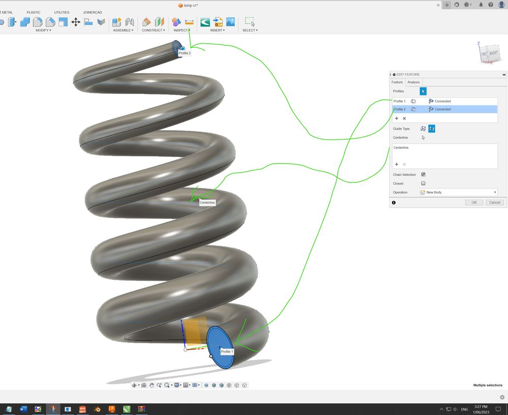

I want to create a spiral tube that starts off with a diameter of for example 20mm then decreases to a diameter of 8mm.   I intend to 3D print this and I want it to be a spiral pipe work that liquid can flow through.  I've create a solid object using the coil feature, however I don't know if I can create a pipe that starts off as one diameter then reduces to another diameter, also its solid, I've tried using shell on the coil but it doesn't have the effect I desire.
Can anyone help ?

Warmingup1953
Here's my go it.

Here's a version with the end faces perpendicular to the helix. I used a pipe around the coil to give me faces to sketch on, could have used plane along path as another option. Only used the pipe because I thought you could set start and end diameters but Fusion can't do that (another program I use can).
See attached file. Was going to just shell the first loft but Fusion created some strange artefact when I tried that. Could be because the seam on the loft is twisted?

Mmmm. OK I'm unsure of the level you are at with Fusion 360 learning journey but here I go....The Yellow body is the Coil. The Vertix of that body is used as a Centreline path. The Pipe (Solid Red) gives you a planar surface at either end...On onbe planar surface you create a sketch of the proposed large end's inside and outside diameters concentric with the spiral path you'll use for the loft (Yellow) You then Loft a solid Outside spiral of diminishing diameter and ditto for the inside then you Combine cut those two solid spiral diminishing solids to create the spiral tube of your desires!

If you're just talking about the spiral, use the edge of the coil. You should use the edge because a surface edge is more accurate than a sketch.
