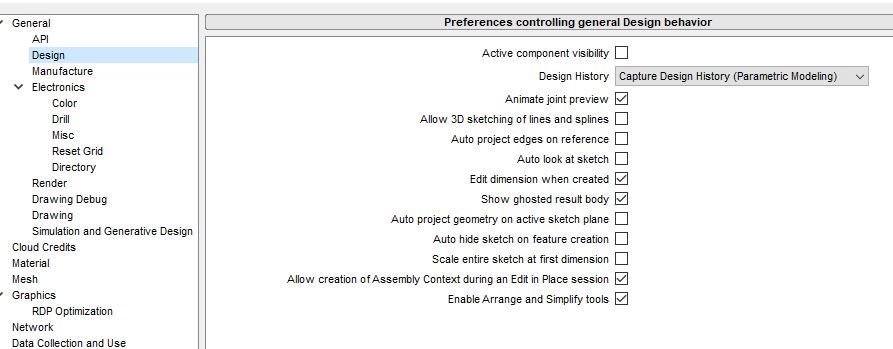

You may need to project the lines from the second sketch to the first (or vise versa) in order to get the intersection, although Fusion 360 may automatically project the line.
Here's the settings I use in Preferences:
I prefer to manually use the coincident constraint instead of relying on Fusion 360 to select the correct lines.
ETFrench
