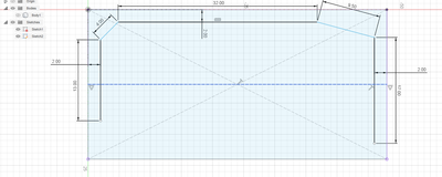

I placed a centerline horizontally in the middle. How do I align the 13mm line so it's in the middle of the centerline?
I want to draw a shape on this rectangular surface. How do I mirror the half shape that I drew? Some of the lines are still blue, how do I lock this sketch so I can extrude it later?
New to Fusion, so any help is appreciated!
Centerline and mirroring
Create a coincident constraint > centre point 13mm line (shift + hold + select centre point) to the centre line

Thank you! How do I add a midpoint of the 13mm line?
watch added screencast >#2
