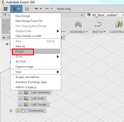

I started a design offline. I have finished it back online, but I cant save. The option is not highlighted. I am back online and will not save. Need help.

Hi @Anonymous,
I assume you are referring to saving it in the cloud? In the meantime, why don't you try saving a local archive file, that way you have a backup in case anything goes wrong. Assuming this isn't an assembly with referenced parts, you can go into the File Menu in Fusion, select Export and export the file as an Archive File Type. I posted a screenshot below showing the steps.
Hopefully this can create a back up just in case anything goes wrong. Then you should be able to upload the .f3d file to the cloud and continue working in the cloud. In the meantime I will ask around and see why this is happening and what the next steps should be. Also, do you think you could post a screenshot showing what you mean by the option isn't highlighted?

The save or export will not highlight.

matt.pooley
The usual trigger for these actions being disabled is if your Fusion entitlement is seen as invalid or expired. I don't see any messaging around this in your application, so I expect something has reached an invalid state. A potential workaround for this is to switch back into Offline mode, and then come back Online.
Additionally, if you can generate diagnostic log files and forward to me over email (matt.pooley@autodesk.com) I can investigate further and identify exactly what happened.
