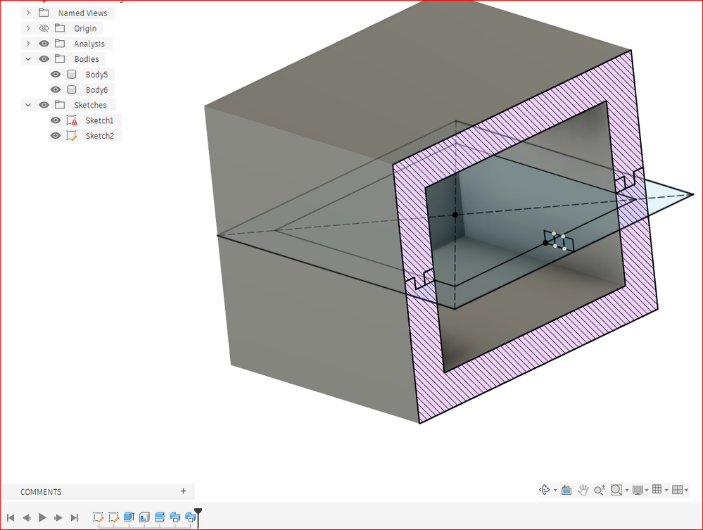

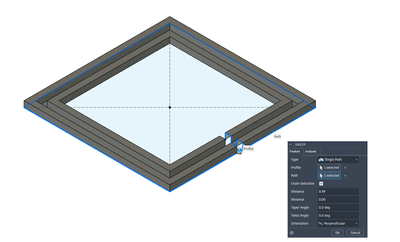

I tried using a surface sweep using a really simple sketch as the profile and a square sketch as the path, they are touching at a single point and the sweep works for any distance as long as it is not 100% of the path.
For example, 99% of the path works:

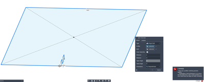

But 100% does not:

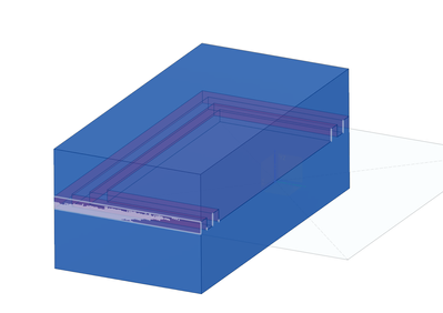

The reason for doing this is because I want to split a body using the surface as a cutting tool, I thought this was a good idea to make a fit between the two parts. If there is a better way, please let me know.
Example of what I want: (but in this case the cutting profile is missing on one side)

But why cant I just sweep 100% of the object? Is it a bug?

The Fusion algorithm doesn't like closed loops.

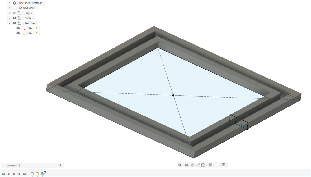

100% path error must be a Surface thing - we have always been able to solid sweep the full Path, with mitred corners if using an internal path.
Why surface at all?  You have been shown how complicated it is.
Split the body with a plane, or separate Extrudes above and below, Solid Sweep the two lips, and Combine > Cut not required either.
I added lip interference into the sketch 2, needs your sized clearance adjustment.
Bonus: Short understandable timeline.
Might help...

One of the best answers yet,using the way you showed I can make parametric and custom fittings pretty easily. Huge thanks.
