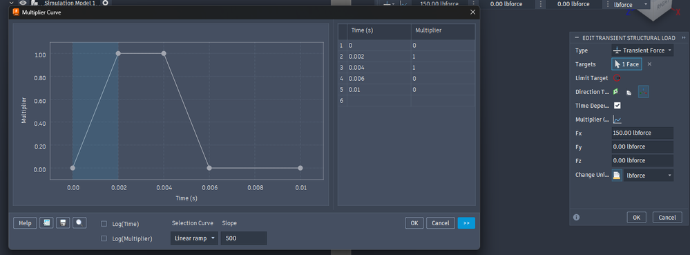

Setup: 0.01 seconds of event duration, 25 steps
Force application: apply load ramped, hold load, release load ramped, hold no load

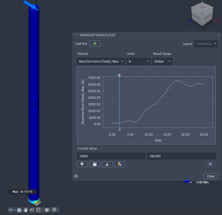

Results for reaction force: shape of reaction force curve does not match force application curve
