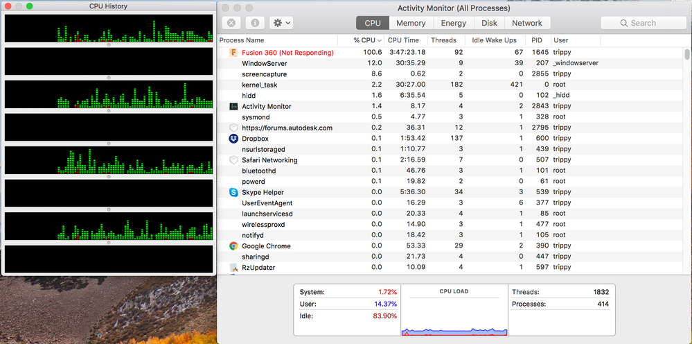

Yet again, Fusion 360 is stalling doing something.
Pressing the ESC key isn't doing anything. Sometimes we have to wait endlessly and because Fusion 360 is rather slow in general even if it finally completes the action we've still often waited several minutes.
Pull the arrow a little to quickly when filleting the "right" geometry. Fusion 360 takes it's sweet time.
Mistype something you wait again. Tough!
3 Years ago the explanation was given than this is complicated. OK. Granted. This was three years ago.
By this time it is totally unacceptable that this still happens and is not fixed!.

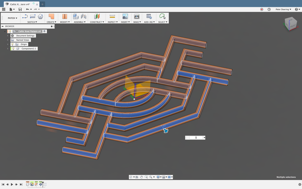

But this time I have a file I can share. I tried to help the user in this thread with the Celtic knot pattern and when I initially tried it with just a part of this pattern it worked. The idea is that I determine the symmetries in the pattern of which there are many, an then create a sketch with only the necessary geometry and pattern that. All driven by user parameters. So far so good.
Then the idea was to extrude the sketch into surfaces in Patch mode and thicken them symmetrically to 1mm (2mm overall width) and apply a chamfer. Initially with fewer sketch elements it worked. The preview shows that it works but now it has been running for 15 minutes at close to 100% utilization 10 minutes of that with the fans blowing full steam (high spec 2017 MacBook Pro ). It's still trying to complete the operation.
The sketch geometry's lines and tangent arcs. I am not trying to thicken a complex lofted surface or shell a complicated body. This should be easy peasy, but apparently it isn't.

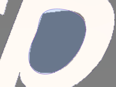

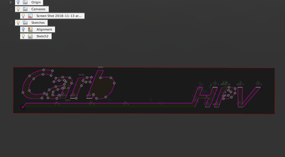

And another one. Completely unrelated. Completely new file. A canvas of a logo and Im am tracing it. in a single sketch.
I accidentally closed the spline and want to delete it. I select the spline and press the delete key, or so I think.
10 minutes later Fusion 360 still has the fans spinning full blast and does not return.
Whatever I might have pressed, there is nothing in this design that should stop Fusion 360 responding unable to take any user input and me having to force quit it.
But unfortunately I cannot reproduce this.
However, Fusion 360 did save the "untitled" file but in the process of "saving" my work sort off killed the canvas.
The background is still there, but the letters/logo are gone 😕
