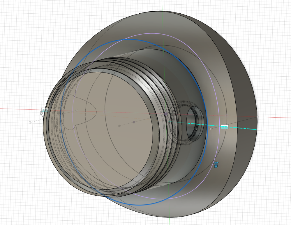

Hi. It's me again. Was revisiting the Project To Surface-command in another model, but he*k if I can get it to work. I do understand the thing about projecting a curve on a separate sketch, but now the projected curve(s) get super-condensed. I have tried three different new files, with various curves that I then project onto the cylinder, but they a.) all get squashed sideways and b.) they all miss a spline here and there. Any ideas?
Edit: tried a super simple three-circle-sketch, and now I only get three red lines projected on the cylinder. (see second screenshot)
Message 23 of 38
davebYYPCU
In that dialogue box, the option Closest point is selected, there is Along Vector, option in the drop down,
sounds like you need that option, or test it, the result would be similar to extruding the flat sketch, if you get what I mean.
To use it you will need to select the Z Axis for your direction.
Might help....

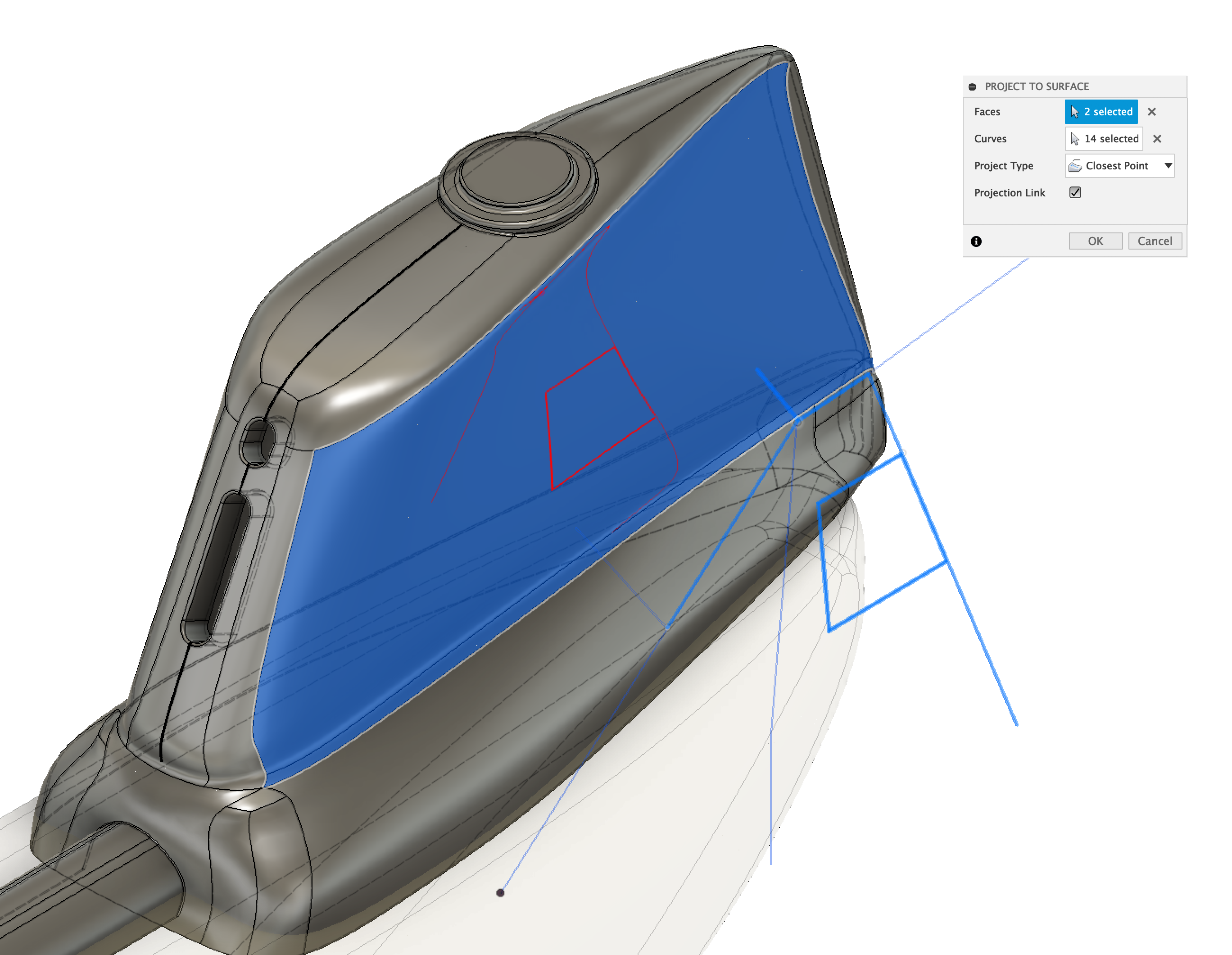

Opening up this thread again since I really don't understand the way projecting lines/shapes onto another object really works. On the model I'm currently working on I would like to project a set of lines (or rather, thin filled areas) and then slightly indent the surface of the model to look like assembled metal plates with a thin gap between. When following the instructions on projecting (earlier in this thread), the lines do project – but in a weird, bent way. I have tried to turn on "along vector", but that does nothing.
I also tried the split object-command, but F360 crashes over and over when doing so. Besides, I don't really want to split the part (the rear fin of a helicopter) since it's going to take me a long time to reassemble and making the model look "solid" again after adjusting the look of the "indents".
Attaching two screenshots of the projecting issue.
Message 26 of 38
davebYYPCU
Your pics show Closest Point, you need along Vector.
How big is this model, Full sized or scaled?
Do you want “Panel Lines” or misaligned faces?
Will the object get made in the real world?
Your answers determine what method to use with the 3d sketch.
Message 27 of 38
mavigogun
File>Export>Save locally>Attach to your reply to this thread.
Along Vector is a bit counter intuitive- if using the Origin Planes, we select the Face  that would provide a direct "window" view of the surface we want to project to.   Super weird.    You can also place Construction features to target the vector.

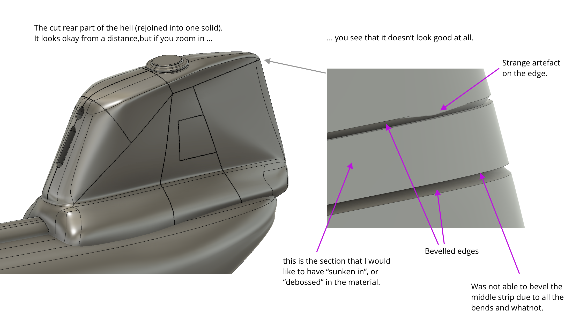

@davebYYPCU Yes, the model is sorta-full-scale (13 meters long in all), but won't be manufactured (I wish, hah). If I finish the model it will be imported into Keyshot for further texturing, lightning & rendering. I don't really know whether I want "panel lines" or misaligned faces, but say that I would like a thin indent in the metal hull, making it look like a joint between metal sheets. My thoughts at this point is to create these in Keyshot by applying various bump textures at the place I want them to, but I originally thought that it would be nice to have most of the details modelled from the beginning.
@TrippyLighting I did manage to split the rear fin in several parts, having the "cut" (or the section between the imagery metal plates) as a separate object. My plan then was to add a small bevel on all parts and the re-join the parts into a single solid again. The bevel between the plate (if that's the correct wording?) + "cut" + next plate would then achieve the effect of being manually assembled when building the helicopter. But, I ran into issues trying to bevel the round surfaces, as well as seeing weird artefacts on some parts, so I scrapped the idea of getting this effect in a modelled fashion. See attachment for visual details.
Thanks for all feedback. Appreciated!
Message 30 of 38
mavigogun
Check to see if that artifact is merely a display artifact by toggling the detail control for the Body-  right-click Browser entry > Display Detail Control > Fixed > High.    Images may be embedded in-post by using the Photos button above the text box.
Message 31 of 38
blacktip
@mavigogun Ah, nice to learn something new. Yes, the visual artefact disappeared when setting it to high. Cheers.Screenshot 2018-11-07 at 14.42.41.png

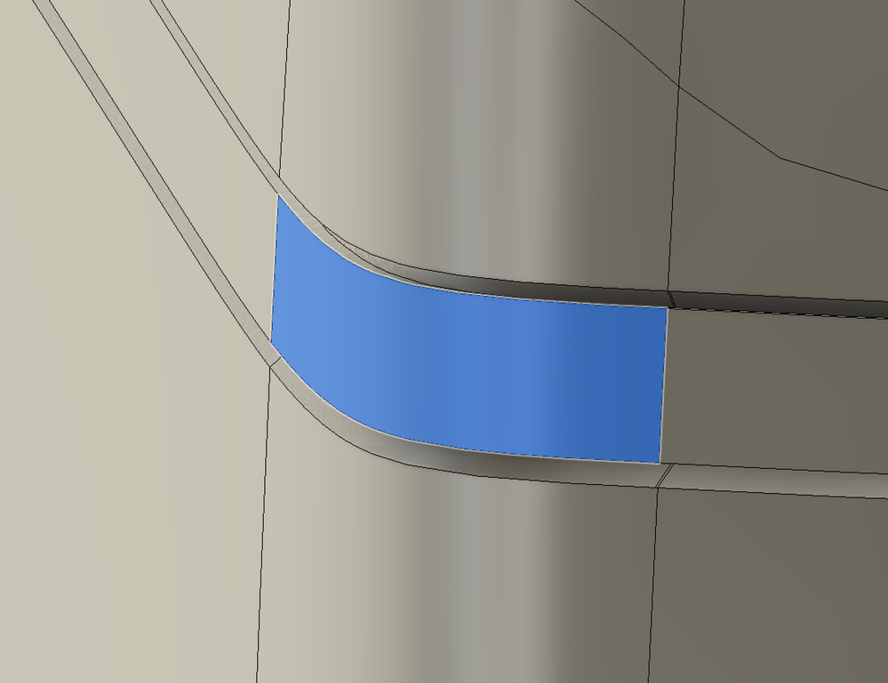

Not to bring up an old thread, but this does not appear to work for me. I followed the guidence about creating a new sketch, but while it shows what looks like a successful projection, it's not useable for any following tasks (e.g. sweep cutout of another profile).Purple line is what I want, but I get a 'failed to project, check geometry' message.Purple line is what I want, but I get a 'failed to project, check geometry' message.
