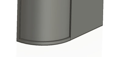

I want to extrude a face which has a radius but when I select the extrude tool I can't select this face, the tool works with the other plane faces with no issue, is that normal and is there a workaround ?

Not a pro by any means but I believe extrude only allows selection  of planar profiles. I think "offset face" from the modify menu is what will get this done.

Unfortunately offset face moves the all body, I guess my model is wrong...
I inserted a stl file and generated a body from it so that might be the issue.
I want to extrude only the curved face but don't want to modify the top and bottom angles.

In the video I show you how to offset the curved surface using the Surface tools.  At the end of the video I remove the fillets, offset both surfaces and then join them back with the fillets.

jeje
Thank you all for your fast and nice support and sorry if I haven't been clear enough.
My goal is to cut a small amount of the surface excluding the top and bottom borders to be able to place leather onece 3d printed.
In the video I posted it's what I'm able to do on a flat surface (beginning of the video) but can't achieve on the curved face (I understood it's not possible to extrude curved faces but was wondering if there is a workaround).

MRWakefield
Like this?
This was done with the "Emboss" tool.

The process I showed could be reversed.  Instead of offsetting the surface out, you can do it in and when using the Thicken command use Cut instead of Joint.

Yes exactly that !
I tried the emboss tool but can't select the sketch profiles ?
Message 16 of 22
MRWakefield
I created a new plane and sketch like this:
Then used emboss. Of course, the sketch doesn't need to be a simple rectangle, you could make it a more visually interesting shape if you wanted.
I've attached the f3d so you can see how I did it.

g-andresen
if you want it to be like @MRWakefield  showed it in his post, you can also do it with a simple extrusion.
