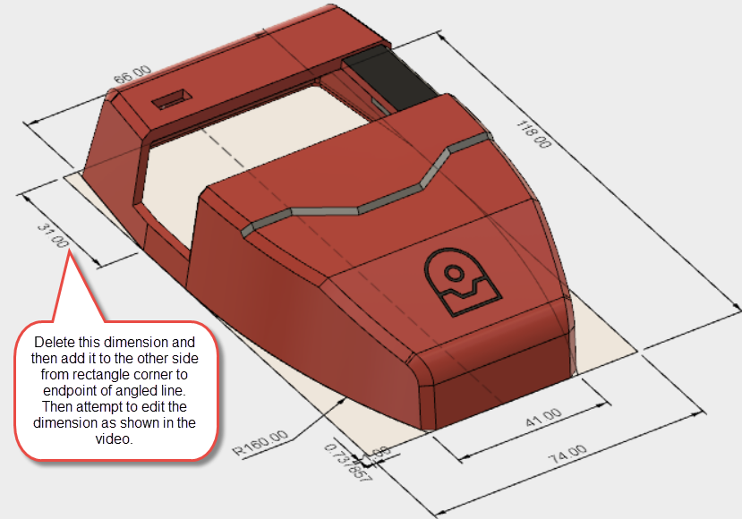

I can drag the line to any length and add a dimension, but then can't edit that dimension?

JDMather
Edit Sketch1 and delete the 31mm dimension on the left side.
If you dimension from the symmetrical point illustrated in the video on the right side to the corner of the rectangle and then attempt to edit the dimension - I get an error.
If I dimension from endpoint to endpoint of the angled line - I do not get an error.
If I dimension selecting only the angled line - I do not get an error.
If I dimension the symmetrical line on other side of the sketch endpoint to rectangle corner - I do not get an error.
If I turn off constrained sketch color (which of course I would not do this, just as I would not turn off my airbags or anti-lock brakes) - I do not get an error.
So the issue is between those two particular points.

jeff_strater
Thanks for the design, @JDMather,  I've filed bug FUS-29943 to track it internally.
The interesting thing about this case is that if I create the dimension differently, (as a vertical dimension to the ends of the angled line), it is fine:

jms30
Community Visitor
Community Visitor
This was just happening with me. I know how to fix it. One of the points included in the dimension is fixed, you can know which one by dragging the point ( point A) and not being able to. After locating which point is pivoted, redraw the line (line AB) but starting from B to A to make point A flexible to move.

etfrench
Deleting the rectangular pattern icon at the origin will allow you to change dimensions.  You may  be better served by using multiple sketches instead of one.
