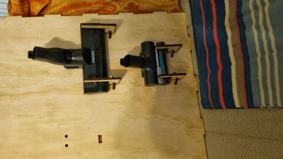

I am not sure the order in which they will be displayed.
Pictures put in one at a time.
Initial positioning test (above)
The wedges being placed.
This is confusing.  I'll put the comments above the piccies now.
The Hooks being positioned.
Oh, and you can see the dowels to hold the charger.
I really messed up with the hole size.   But with some help bigger dowels were used and tapered down for the charger.
Very tight fit.   (Pushed in from the back - with glue)
The original problem with the dowels and the hole sizes.
