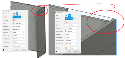

Only to highlight the problem I set a value.
ONE SIDE.....   Not happening when I try.
TRAIN WRECK at this end.
Message 63 of 89

Screenshot (1375) - Copy.jpgAs you showed me in the picture from your screen shot.
That is after I click on "one of the lines".
The entire perimeter gets selected, and so the lot gets extruded.  Not as you show it.

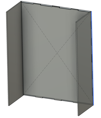

Shown from the back to (I hope) show I've got the two side panels working with their joints.
But when I do the top one.....   I lose the finger joints on the back panel.
This MAY be a better view.  Before i set the thickness of the top piece.
After a bit of re-re-re-reading...
This is what I have:
Green = good.
Red:  not so.
Lack of finger joints.
EXTREME lack of commands in that.
I had to "thin extrude" to NEW BODY (NOT CUT as you said)
Then do a COMBINE bit with the KEEP TOOL BODY.
THEN I got this.

1 - the second sketch 4:18.   Ok, the "origin" is at/on the back of the back part.
You make a construction line from there "out" (forward) the thickness of the wood.   Then a second one form the front of that line.    The distance is set to the depth.....
From there you put a vertical line at that line's mid-point.
Problem (for me)
That means the vertical line will NOT be in the middle of the side piece.   It will be offset by "thickness"
I know it is nothing in the greater scheme.   We are only making finger joints.
2 - The "52" is depth / 5 and I picked that just for a nominal number/size of fingers.
(Ok, only 2 questions).

7mm is pretty thin and if the wood is soft it will compress, but just the same, check with your laser guy about the corner reliefs (dog-bone).
I will have to make another video about laying out the Components and Save As dxf of the sketch.

I may be wrong, but the kerf (mine is 0.2mm) of the Laser is sufficient to account for the (dogbone) corner,
but they would be needed for a router.
@mark33.in.oz  Did you investigate DXFer?
Selects the face of each part, puts them into one file.
While I am here, the last set of fingers will be in the middle of the visible inside face.

Tabs / sockets - interlocking fingers.
Side wall inside visible face -
can't see into or past the floor, so 7mm less than the outside face when assembled,
Might help....
