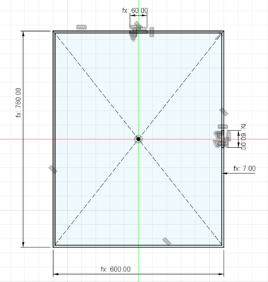

Message 41 of 89
TheCADWhisperer
@mark33.in.oz
The next few steps will demonstrate the real power of parametric modeling - let the software do the work for you.
To get the next few steps - first follow this 4 minute video.
(view in My Videos)

Extrude the offset rectangle -Thickness.
Right click on the sketch and turn visibility back on.
Extrude the finger tab rectangle at top by -Thickness and Join.
Extrude the side finger tab as a separate Extrusion.
Oh wait a minute - your Work in Progress is not completed.
Did you watch the video.
Blue lines and white dots should keep you awake at night.

Message 50 of 89
TheCADWhisperer
@mark33.in.oz wrote:
Yes, I am on the same page.
The rectangles constrained correctly now.
Extruded.
@mark33.in.oz
Attach file here so that I can see progress before next steps.

TheCADWhisperer
@mark33.in.oz
I hesitate to turn you loose on your own - but it might be entertaining.
I’m going to bed.
The next step is to midplane (symmetric, whatever) Rectangular Feature Pattern - Join one of the tabs.
Then repeat with the other tab.
Then Mirror tab and the pattern.
Repeat Mirror tab (Extrusion) and the pattern.
Will be fun to see result in the morning.
After that we’ll look at simplifying the “t-slots”, more Patterns and dxf test.
I’m signing off for tonight.

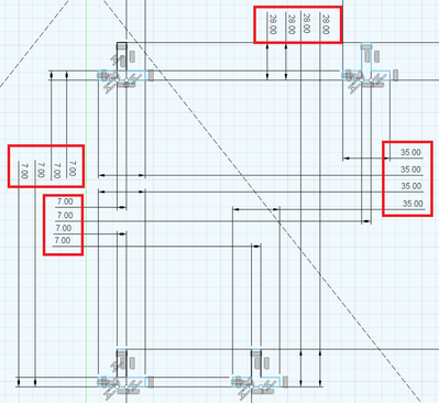

Message 59 of 89
TheCADWhisperer
@mark33.in.oz
I see an enormous amount of repeated work in Sketch1.
Get Lazy!
Let's start over...
Back to our nice simple Sketch1.
Two mirrors and ONLY two mirrors as shown.
If you can't figure out this step - STOP and ask questions.

So that way was not an option.
I had to do it in two steps.
So by that point I had all the tabs and the symmetry ok.   (Or so I thought)
I then got industrious and tried to get the rest of the bodies and their tabs.
Again:  I messed up and so went back and worked out how to do it "the other way" you are showing me.
I am not seeing any benefit to either way.  So trying to change my mindset to your way simply because you say this is the way to do it is not as simple as you may think.
So:
With all the sides/top/bottom/etc done:
I went back and had to add the extra stuff for the back plane that are needed.

I am suspicious you are going to offer/submit a way of doing what I did by - rather than adding sketches - duplicating the "extrudes" at their relevant places.
Again:  I can't see an advantage of doing it that way.
You showing me the screen shot with the blue lines (which you don't like) is only rubbing salt in the wound.
I am not smart enough to know how to do all those things to get rid of them and again is why I am asking.
