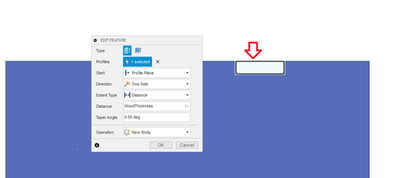

For the sake of "try before I buy" (no not buying fusion) for the sketches to export for the laser printer I shall see how that works with what I have in the mean time.
Just to get the feel for it.

TheCADWhisperer
Wayyy too much work?
But in any case -
can Save as DXF at any time.
I don't understand why you are using all of those finger joints in the Insert anyhow - in my experience only the sides use finger joints.  I guess maybe if all you have access to is laser cutter and no access to router.
Actually, in my previous image it would probably be better to Project the Face into a new sketch and Save as DXF...
Close up of a corner - no extraneous construction lines, no white dots, no blue unconstrained lines.

davebYYPCU
I want to have all the pieces on one sketch.
Not available from Fusion the way it works now.
Download DXFer, from Github.  It’s an Addin.
When you get that running, you only have to click on the face of each part, to put them in one sketch.  Use the Layers setting, each part will be separated onto dxf layer for nesting.
Might help.....

TheCADWhisperer
@mark33.in.oz wrote:
Yes, TheCADWhisperer is also helping me.
@mark33.in.oz
Start a new file.
Create the User Parameters shown below...
Because we will use a master multi-body technique there is no need to create Components at this time.
Start a New Sketch and sketch the rectangle as shown below...
Change the Linetype to Construction and Offset the boundary towards the inside as shown below...
Edit: Actually - don't change to Construction but do be sure to use Offset command (do not use Rectangle command).
What do you note about the color of the Offset lines after clicking OK?
Toggle back to normal linetype...
Sketch a 2-point rectangle to the right as shown...
And sketch a rectangle at the top as shown.  Dimension with the appropriate named Parameters.
Add Midpoint constraints between the lines as appropriate (shown below)...
In the image the top finger tab constrained and about to add the last Midpoint constraint to the side tab rectangle.
Finish sketch and save the file.
Attach the new file here for next set of simplified steps (as compared to the reference video where too much work was done.
