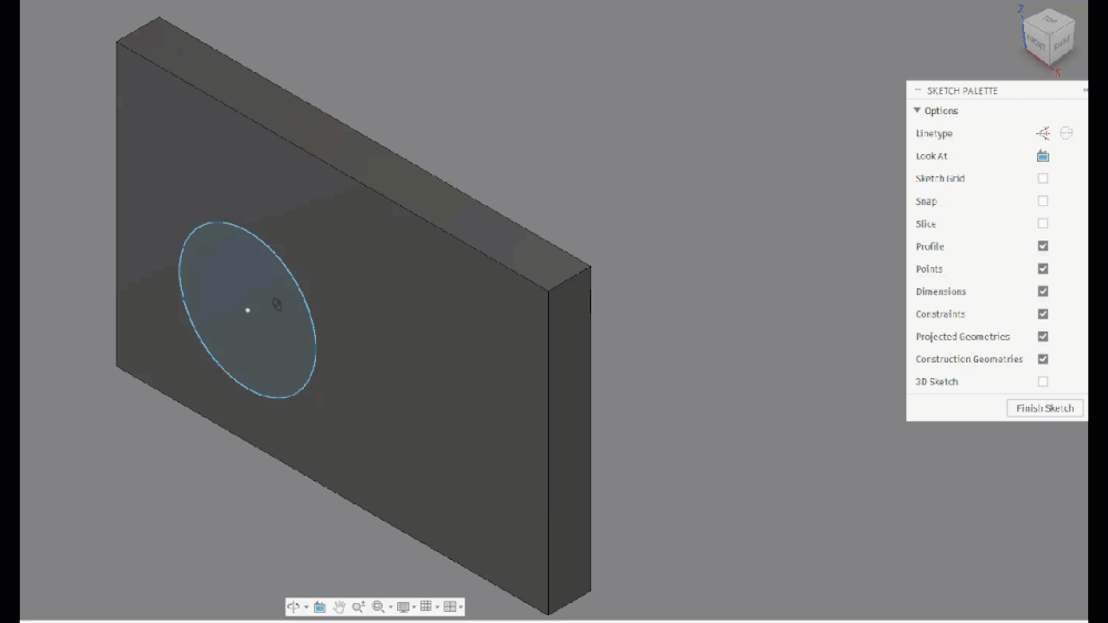

If what you are seeing is illustrated in the attached Animated GIF, it is completely normal.  What the application is seeing is a potential surface to index the dimension from.  If this is not what you are experiencing, please attach a video showing your exact issue.

What I'm seeing is similar, but it's happening to the face the circle is drawn on in your example as well as other faces.
