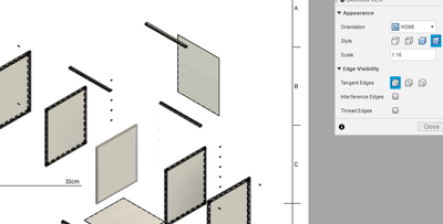

The components are being applied to an old design file, then linked to the drawing file. However, they do not appear in the same way as other components. Below is a screenshot of the drawing file showing this issue. I am experiencing this issue after the latest update.
As of now, I am deleting this storyboard or model in the drawing file & then reapplying it so that it shows correctly. The process is similar to starting with a fresh drawing file. Please Let me know what the solution is.

Sorry to know that you are facing this issue. Can you please share the f3z file with us so that, we can debug this case?
Also, I wanted to know if changing the style through View edit dialog?

Thank you! I can reproduce the issue with the given sheet but not from scratch. An easier way I found out to see the correct view is by changing the style to something different then back to shaded with edges through view edit dialog (double click the view)
I will take this file to the team to dig a bit deeper to find the cause of this issue.

Thank you for your support. Previously same drawing files. This process has been updated previously with no problems. I tried what you suggested and it worked.

Hello @rohit.bapat,
Please find the below screenshot. The screenshot below shows some files that even this type of technique does not work. If it is Version 1 F3z, then what you suggest will work.
