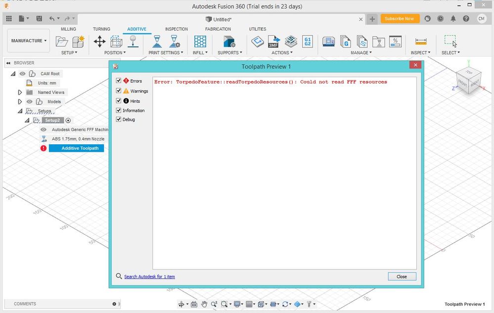

I am using a trial version of Fusion 360 and trying to 3D print a simple geometry.
At this moment, I am trying to set up the print protocol using the Addition menu from the Manufacturing. I followed the steps from this tutorial:
https://help.autodesk.com/view/fusion360/ENU/?guid=Fusion_CAM_tutorials_fff_setup_walkthrough_html
I am stuck at defining the print settings. No matter what print settings I select, if I want to edit them, there are no tabs to go through (see attachment). Also the setup window is missing the edit button of the print settings (see attachment).
The main issue is the print settings editor. Can you tell me why the tabs are missing?

Hello @serge.quiblier ,
Thank you again for all your trouble.
I have installed the software on a different PC with windows 10, the one experiencing problems has window 8.1. Everything is working properly there, but unfortunately that PC is not as good as the one I am using. It might be the OS that causes the problem because I even tried to install it on another strong PC, that unfortunately has windows 7 on and I experienced the same issues I presented here.  So, using windows 10 might be the key.
I tried to reinstall on the windows 8.1 PC with no success. Unfortunately, reinstalling OS might not be an option, as will need to reinstall some other sensitive software, that are not easy to install.
I even saved a project built in the windows 10 version, and when I opened it in windows 8.1, I was able to see the print editor tabs. But that was only for this particular file. If I tried to create a new one, I experienced the same problem.
The libraries might have some issues, I can import what I need, but I cannot edit them. I did import the file from you and been able to see the tabs from the editor Tabs.JPG.
But I am experiencing another error when I try to generate a toolpath. That error was not present in windows 10, following the same procedure.
