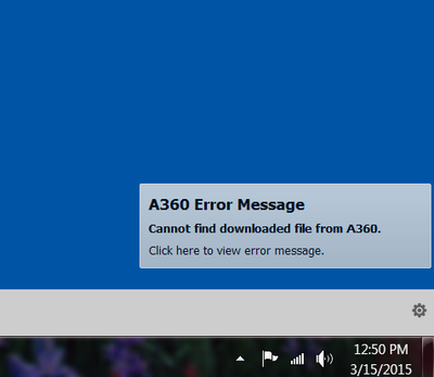

Cannot Find Downloaded File.
Ummm....doesn't matter what file I click on, nothing is available. I did not do any work yesterday in offline mode. I fired up Fusion this morning, let it do it's update, enabled On-line mode, restarted, bam! nothing.
Suggestions?

The error message I recieve is this:

To provide an update to this thread, the issues which have been seen here are linked to network security, with the issues arising when computers are unable to validate the authenticity of Autodesk's server certificates. This check was added to Fusion 360 in the most recent release as a way to block many 'man-in-the middle' attacks.
At the moment, we don't have a clear understanding of the trigger for the problems and are continuing to investigate, however a workaround has been identified and has allowed impacted users to continue to work with Fusion. Since this workaround avoids a security check, we will not be releasing it publicly at the moment. If anyone encounters a similar issue, please contact me through a Private Message or post to this thread and I will be able to validate and provide details.

We have made some progress on this issue, it appears to be caused (in at least some cases) by a missing Windows Update.
The specific update is KB931125 and can be found through the Microsoft site at http://catalog.update.microsoft.com/v7/site/Search.aspx?q=root%20certificate%20update (Note - this page may require Internet Explorer)
Applying this update should remove the need for a security workaround.
