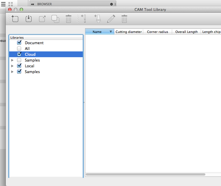

Message 4 of 20
Also ran into this bug. Not related to my previous message.

That screenshot shows a window that's way too empty -- are there any meaningful entries in your application logs? Feel free to attach them here, and we can take a look.

So the file is persisting to A360 which is good but it will not show up on my Mac client.
