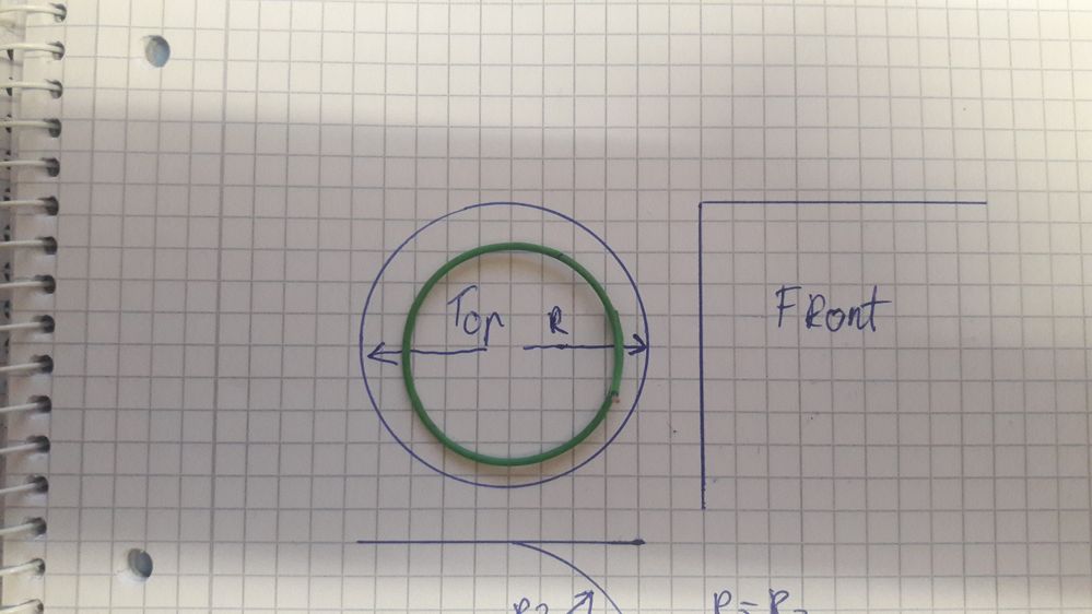

I'm trying to draw a hole of this shape in a cylinder, but it looks like creating such a 3D shape will take at least half a day. I tried both spline options, conic curve, and arc.
With the fitpoint spline, it almost works, but in that case, the front shape doesn't come out right, and the circle becomes not quite round.

If you edit the sketch and reduce the angle, what do you observe?
Also, the geometry in your sketch is impausible and does not reflect the actual physical part.
The views in your sketch contradict each other!

Here’s what I mean. If I use a spline, everything has to be done manually. That is, each point needs to be moved along the XYZ axes until it somewhat resembles an arc or a circle (depending on the viewing angle—top, side, or front). But maybe there's a way to ensure that a circle stays a circle, an arc stays an arc, and the front view is a perfect 90-degree angle instead of something that just roughly resembles these shapes, like it does now.

Here is the real part and its view from the top, side, and front.toptopfrontfrontsideside
In reality, forming this part took 1 minute in the Fusion program...

This is what I see in your design intent.
The Front and Side view in your drawing doesn't add up for me, one of them feel rotated.

Spot on. That little radius the OP left out of his simplified paper/pencil sketch makes all the difference.
