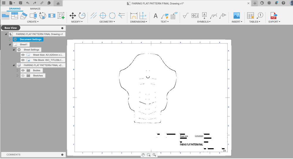

Screenshot 2023-12-05 172634.pngI am trying to get a drawing but anytime I load the file into a new drawing it shows up like this even when zooming in. It fixes itself when I zoom far out. My graphics card is up to date and so is Fusion I am not in a custom drawing template either which I know are both issues.
I have a RTX 4070 Geforce and a intel i9

Hi @ryan_kirkN5LME
fuzzy graphics are usually caused by the graphics card driver being out of date. Windows update sometimes rolls back driver versions (particularly AMD for some reason).
try updating your graphics card driver.

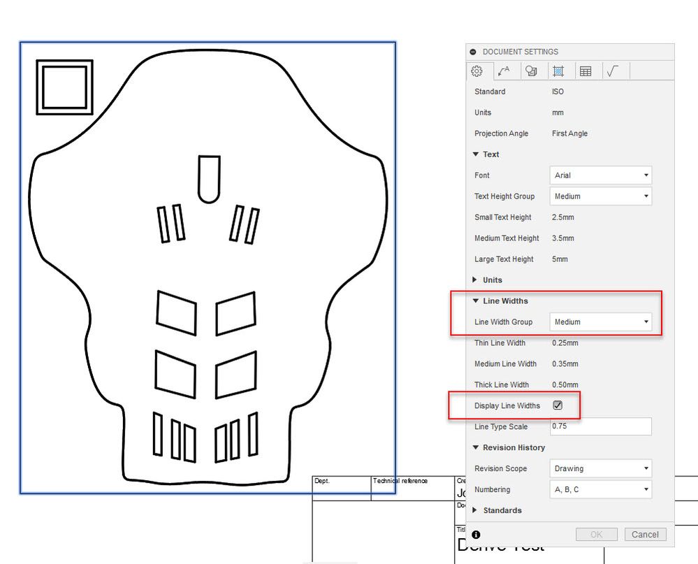

jhackney1972
Give this a try, open your drawing, go to Document Settings in your Drawing Browser and on the first tab, change you Line Width Group to Medium.  Also before clicking OK, place a check in the box beside Display Line Widths.
John Hackney, Retired
Message 18 of 31
ryan_kirkN5LME
Have those settings already no difference I even tried changing the widths and there was no change
