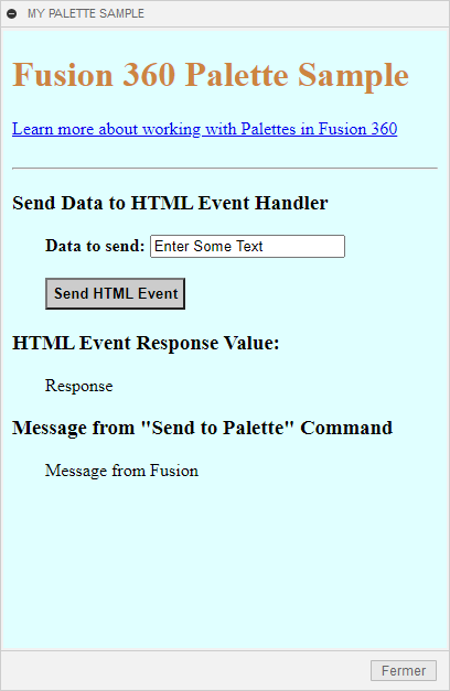

I just setup and installed the files found there: Fusion 360 Help | Palette Sample | Autodesk
Everything is working just as expected which is very nice and give me ideas for a plugin I have in mind.
The mystery is that, for example, I see as a title in the HTML document "Fusion 360 Palette Sample", but I can't find this string in either the .py file or the .html file.
I also added some  css, like this:
<head>
        <style>
            body {font: normal, Verdana, Arial, sans-serif; font-size:large;}
            p    {color: rgb(38, 0, 255);}
        </style>
    </head>
but I can't see any difference in the displayed html, while I see it in VS Code (Extension HTML Preview), even after I stopped and restarted the plugin.
It would be a great help in using this feature to have those "mysteries" solved!

This is not the code of the add-in you created.
The documentation can be confusing:
Edit the add-in and check the code under the resources/html folder:
For the CSS, a good pratice is to use a separate file. You can add it in the resources/static folder.
For example style.css:
body {
    background-color: lightcyan;
h1 {
    color: peru;
    font-weight: bold;
Then you call this file in the <head> section of the HTML file:
<head>
    <meta charset="UTF-8">
    <title>Title</title>
    <link rel="stylesheet" type="text/css" href="static/style.css">
    <script type="text/javascript" src="static/palette.js"></script>
</head>
 You have to stop and run the add-in to see the modifications:
