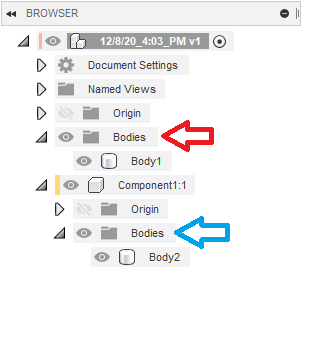

One of them is a group of bodies.

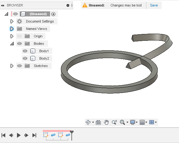

This is illustrated by the data in this state.

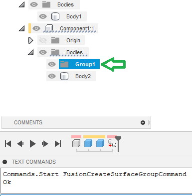

Make the Bodies of RootComponent (marked in red) selected and execute the following TextCommands.
Commands.Start FusionCreateSurfaceGroupCommand
You can make a group without problems.
Then execute the TextCommands in the same way with the "Component1:1" Bodies (marked in blue) selected.
This one is also created without problems.

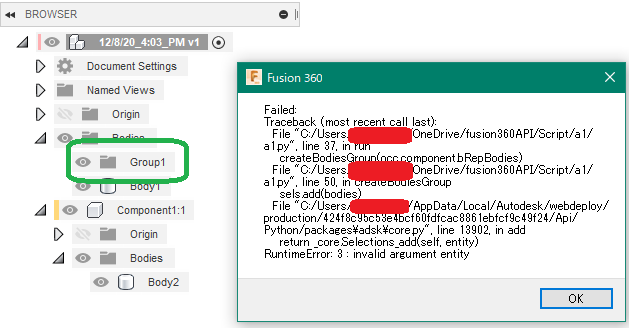

To perform these same processes, we created the following script.
        # occ
        occ :adsk.fusion.Occurrence = root.occurrences[0]
        if occ.nativeObject:
            print('{} has nativeObject'.format(occ.name))
        else:
            print('{} has not nativeObject'.format(occ.name))
        createBodiesGroup(occ)
    except:
        if _ui:
            _ui.messageBox('Failed:\n{}'.format(traceback.format_exc()))
def createBodiesGroup(
    root_occ :adsk.core.Base
    # select bodies
    sels :adsk.core.Selections = _ui.activeSelections
    sels.clear()
    sels.add(root_occ.bRepBodies)
    # execute TextCommands
    _app.executeTextCommand('Commands.Start FusionCreateSurfaceGroupCommand')
Unfortunately, RootComponent creates it, but Occurrence(Component1:1) results in an error and cannot be created.
I do not know the cause of this error.
(Maybe it's because I don't understand NativeObject and Proxy correctly.)

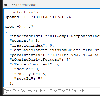

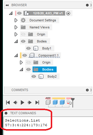

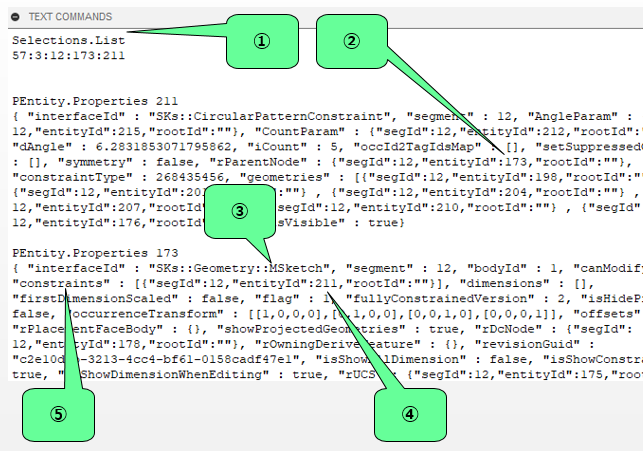

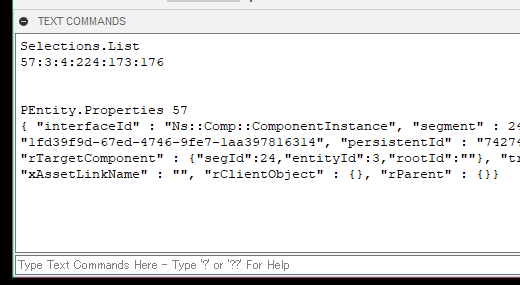

To verify the <paths>, select the Bodies of "Component1:1" in the GUI and execute the following text command.
Selections.List
https://github.com/kantoku-code/Fusion360_Small_Tools_for_Developers/blob/master/TextCommands/TextCo...
The numbers displayed may be different.
Each of these numbers seems to be represented as <EntityRef><EntityID>.
We could use this one to see the properties of the entity.
PEntity.Properties <EntityRef>
Let's try it out with "57".
The return value seems to be in JSON format.
Since it is tedious to check them one by one, we will create a script like this one to check them.

In my environment
prop_txt = _app.executeTextCommand(u'PEntity.Properties {}'.format(id))
with the same function because the output was not clean in
import neu_server
prop_txt = neu_server.get_entity_properties(id)
to use.

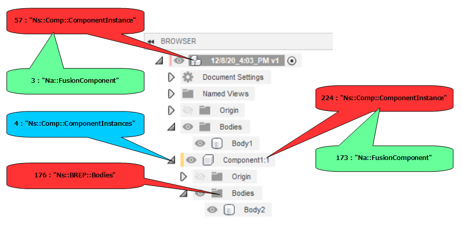

Since it is not practical to write out all the information because there is a lot of information to be output, this is what happens when you only write out the "interfaceId" key.
Also, I would like to add my prediction based on the name of the key.
57 : "Ns::Comp::ComponentInstance" - Occurrence?
3 : "Na::FusionComponent" - Component?
4 : "Ns::Comp::ComponentInstances" - Occurrences?
224 : "Ns::Comp::ComponentInstance" - Occurrence?
173 : "Na::FusionComponent" - Component?
176 : "Ns::BREP::Bodies" - bodies?
I didn't expect there to be a kind of Occurrence in the RootComponent as well, but it feels more natural.
(If you select only the root component and run the script, it only returns "57")
Also, if you look for the following entityID from each property, you will find it with a key like this
57 : "Ns::Comp::ComponentInstance"['rTargetComponent']['entityId'] -> 3
3 : "Na::FusionComponent"['rComponentBaseInstances']['entityId'] -> 4
4 : "Ns::Comp::ComponentInstances"['children']['entityId'] -> 224
224 : "Ns::Comp::ComponentInstance"['rTargetComponent']['entityId'] -> 173
173 : "Na::FusionComponent"['rBodies']['entityId'] -> 176
This way you have relative information.
The image in my head looks like this.
I could be wrong.
Red is the elements that can be selected in the GUI (mainly occlusion) and green is practically not shown.
Reference source (component). A collection of each element that is not even shown in blue.
I was surprised to find that the root component also has an occurrence.

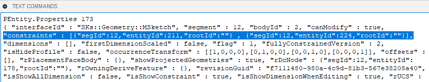

Based on the entityID of "224", you can run "PEntity.Properties" to get the next required entityID.
"rOwningDeriveFeature": {},
"rTargetComponent": {
"segId": 25,
"entityId": 173,
"rootId": ""
"transform":
For TargetComponent, it is also valid here.

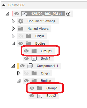

Based on these, let's fix the erroneous script.
# Fusion360API Python script
import adsk.core, adsk.fusion, traceback
import json
import os
import neu_server
_app = adsk.core.Application.cast(None)
_ui = adsk.core.UserInterface.cast(None)
def run(context):
    try:
        global _app, _ui
        _app = adsk.core.Application.get()
        _ui = _app.userInterface
        des :adsk.fusion.Design = _app.activeProduct
        root :adsk.fusion.Component = des.rootComponent
        # root
        createBodiesGroup(root)
        # occ
        else:
    except:
        if _ui:
    try:
        global _app, _ui
        # get Selections
        sels.clear()
        # select root or occ
        sels.add(root_occ)
        # get root_occ <paths>
        linesep = os.linesep
        occPaths = _app.executeTextCommand(u'Selections.List').rstrip(linesep)
        # get root_occ entityID
        occId = str(occPaths).split(':')[-1]
        # get root_occ property
        propTxt = neu_server.get_entity_properties(occId)
        prop =  json.loads(json.dumps(propTxt))
        # get target component entityID
        compId = prop['rTargetComponent']['entityId']
        # get component property
        propTxt = neu_server.get_entity_properties(compId)
        # get bodies entityID
        bodiesId = prop['rBodies']['entityId']
        # create bodies paths
        bodiesPaths = '{}:{}:{}'.format(occPaths, compId, bodiesId)
        # select bodies
        sels.clear()
        _app.executeTextCommand(u'Selections.add {}'.format(bodiesPaths))
    except:
        if _ui:
When we did this, the group was created successfully.

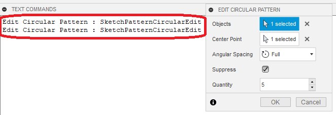

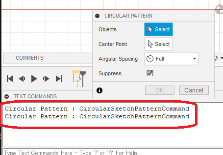

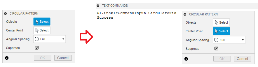

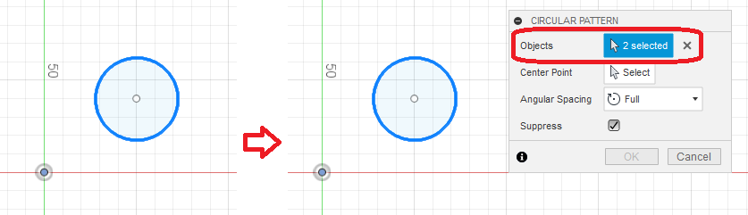

The actual operation in the GUI. First make a sketch and draw one circle.
Select the circle and the sketch origin to make the circle a circular pattern with the sketch origin as the center point.
If we call the circular pattern command in this state, unfortunately, both of them are captured as objects.
You can see that "preselect + command invocation" fails, but now we know how to make it work.
〇Find the CommandID
First, check the command ID.
You can also check it by the method previously described here.
https://forums.autodesk.com/t5/fusion-360-api-and-scripts/use-textcommands/m-p/9645688
This time, I will use this add-in that I made myself.
https://github.com/kantoku-code/Fusion360_Small_Tools_for_Developers/tree/master/CommandLogger
It's a simple matter of displaying the "Command Name : Command ID" called by the GUI operation in the TextCommands palette after launching the add-in, but I like it because I can check it as I go along.
The command ID for the circular pattern of the sketch is "CircularSketchPatternCommand".

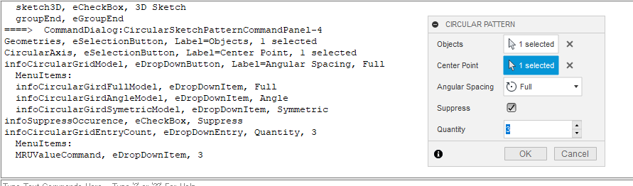

〇Find the InputID of a dialog.
We then examine the InputID of each of the command dialogs.
Previously, we used this one from TextCommands, but some items were not displayed.
UI.CurrentCommandInfo
I searched for it and found that this command also displays the InputID.
Toolkit.cmdDialog
We can see that the InputID used in this case looks like this
Objects -> Geometries
Center -> CircularAxis
Quantity -> infoCircularGridEntryCount
〇Set the entity or value to a dialog

I have found another way to do it.
UI.EnableCommandInput <InputID>
Using this function, you can move the focus to the specified InputID.
(However, it is limited to the Input for selection)
Move the focus to an arbitrary Input and add
userInterface.activeSelections.add(<API Object>)
to select the desired element, and you have assigned it to the Input.
    # get selections
    sels.clear()
    # set Objects
    _app.executeTextCommand(u'UI.EnableCommandInput {}'.format('Geometries'))
    sels.add(tragetEntity)
The "Objects" and "Center Point" is resolved in this.
As for the "Quantity," we already solved that last time, so here it is.
    # set Quantity
    _app.executeTextCommand(u'Commands.SetDouble infoCircularGridEntryCount 5')
After that, just run it and the circular pattern will be created successfully.

Next, we need to select the "Circular Pattern", which unfortunately is not provided as an object in the API.
We need to find <paths> as we did when we selected bodies.
I used the following procedure to find it.
First, select "Circular Pattern" in the GUI, then use the TextCommands to get <paths>.
It will be ①.
Selections.List
57:3:12:173:211
(The numbers themselves may be different from yours)
The entityID of the "Circular Pattern" is "211". We can also see that its parent entityID is "173".
For now, we'll check the "211" property and find "173", which means we can get the parent entity with the "rParentNode" key. It will be ②.
Next, let's check the "173" property." interfaceId" is "SKs::Geometry::MSketch".
So, this is probably the sketch. It will be ③.
Find out "211" from this property. It will be ④.
You can see that it is in the "constraints" key. It will be ⑤.
    # select Sketch
    sels.clear()
    sels.add(skt)
    # Get <paths> from Sketch
    linesep = os.linesep # Get the line feed code for each os.
    sktPaths = _app.executeTextCommand(u'Selections.List').rstrip(linesep)
    # Get entityID from Sketch
    oktId = str(sktPaths).split(':')[-1] # The last number is the entityID.
    # Get Property
    propTxt = neu_server.get_entity_properties(oktId)
    sktProp =  json.loads(json.dumps(propTxt))
    # Get CircularSketchPattern entityID
    # Normally, you should check "interfaceId" and so on, but we have simplified it.
    circularSketchPatternId = sktProp['constraints'][-1]['entityId']
There is only one "circular pattern" in this sketch, so it is displayed as shown in the image, but the "constraints" key is essentially a list, and multiple values can exist.
If you create another circular pattern and look at the properties, you will see the output like this.

〇Modify the settings
After that, call "SketchPatternCircularEdit" to display the command dialog.
You can modify the Input as you did when you created the circular pattern.

I found out how to change the value of "eDropDownButton", which I hadn't known how to do for a long time.
"eDropDownButton" is a CommandInputs like this.
The final step is to modify the pipe command here.
Find out the ID of Inputs in advance.
Execute this command while the command dialog is displayed.
Toolkit.cmdDialog
For more information about "Toolkit.cmdDialog", please refer to here.
https://forums.autodesk.com/t5/fusion-360-api-and-scripts/use-textcommands2/m-p/9937199#M12120
You will see that the Inputs ID looks like this.
The value of the "eDropDownButton" can be changed with the following command
Commands.SetString <InputsID> <MenuItems ID>
For example, if you want the "section" to be a square, you would use
Commands.SetString infoSectionType infoRectangular

The result is shown here.
The "eDropDownButton" is used in so many command dialogs that not being able to change it would be very inconvenient.
This may allow you to incorporate functionality into your scripts/add-ins that you have previously given up on.
