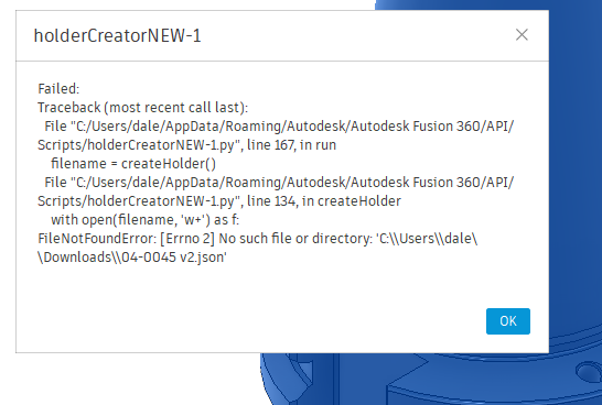

I can't seem to get the script to work.  I have no idea what I'm doing, I followed the video by NYC-CNC.  Although probably not relevant, it appears that the script has been edited to include a pop up instructional screen and a file name input field.  The error message I receive is below.  Any help would be greatly appreciated.  Thank you.
Failed:
Traceback (most recent call last):
File "C:/Users/dale/AppData/Roaming/Autodesk/Autodesk Fusion 360/API/Scripts/holderCreatorNEW-1.py", line 167, in run
filename = createHolder()
File "C:/Users/dale/AppData/Roaming/Autodesk/Autodesk Fusion 360/API/Scripts/holderCreatorNEW-1.py", line 134, in createHolder
with open(filename, 'w+') as f:
FileNotFoundError: [Errno 2] No such file or directory: 'C:\\Users\\dale\\Downloads\\04-0045 v2.json'
