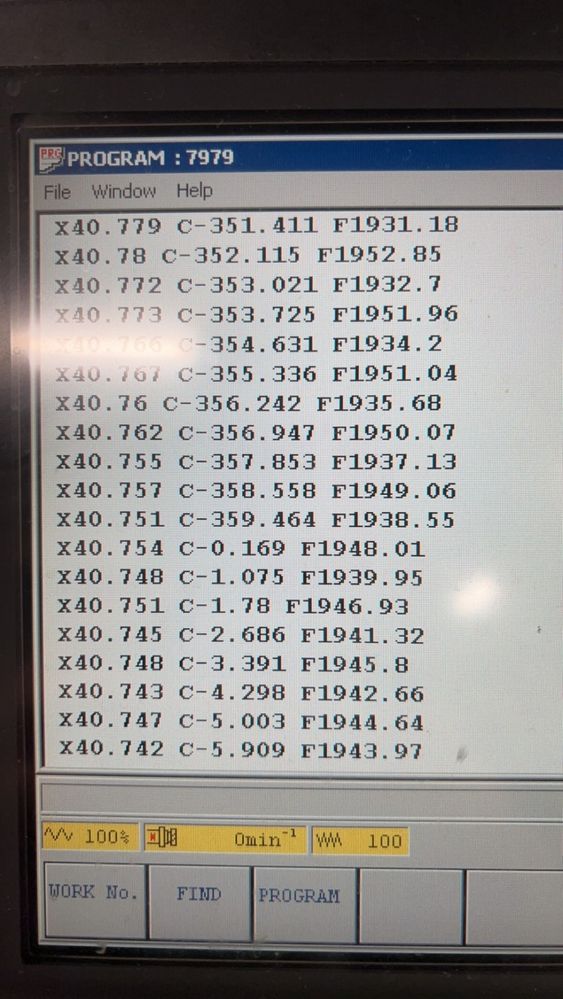

Im new to mill/turn and i just started with Mazak MSY250, i have a problem when it comes over 360 degrees and starts over again on 0 instead of keep going it switches direction and mill away everything it comes over.
Is it an option in fusion so it keeps going over 360? Or is it something in the machine im missing?mazak1.jpgmazak2.jpg

Joshua.mursic
This seems like a problem with your post processor. What does you machine configuration look like in your post?

The Mazak Quick Turn 250-MS post processor probably needs to be modified.
Inside the post try looking for a line of code that reads like this:
var cAxis = createAxis({coordinate:2, table:true, axis:[0, 0, 1], cyclic:true, preference:0});
the cyclic argument means that the axis can rotate indefinitely. If that argument is a range instead, then the C axis will rotate to 360 and then turn back to 0 to start the rotation.
