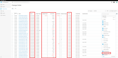

In short there are views we have that we consider an internal Project view, but I don't want the owner to see.  I want to still be able to wipe columns off of it or filter it down some more.  I want people in my company to have a default view that is different from the default view the owner can see. Currently this is not possible.  We need to control what the owner see's and eliminate unnecessary questions.
Example: In the PCO screen the Scope means nothing to the owner and raises questions because they can see it, and we cannot hide the  but it means a lot to us.
If I can control the views that the owner can see it will allow us to enhance their experience and not cause us pain.

@ian_turner.  Most of this is in the PCO screen.  From my understanding, the scope does not mean anything to the owner.  It is alarming to me that the Cost Impact showing.  I don't think they would need the Budget Impact since they have the Submitted value, but I could be OK with that column.  Integration State is one they do not need in our environment, unless the intent is the Owner can integrate into their log in on our project?    Type depends on how disciplined the Project team is.  If they keep messing up the type it creates questions and generally, we only show them the types that we are having them approve.

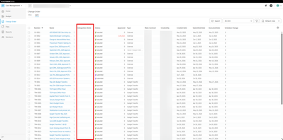

The ACO screen is better than the PCO screen, but we do not need the Integration State shown for them and we would like to be able to filter out the Budget Transfer type.

Also find alarming we show cost impact, especially if it was a fixed price. Seems we missed it when we implemented cost impact when you use the PCO as COR setting. It is fine in normal COR views. Will fix asap, thanks for the heads up.
Also agreed on integration state although is turned off by default.
Type is just change order type so i think could be valuable to the owner?
