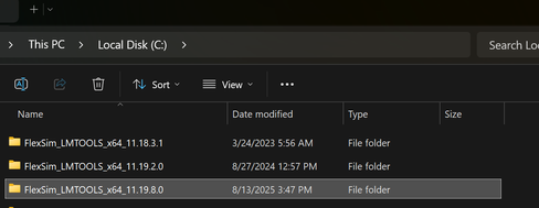

FlexSim 25.2.0 includes upgraded third-party licensing libraries which require an updated set of license server files based on Flexnet Publisher version 11.19.8.0 or higher. For background, see Version Compatibility Between Components. In terms of that article, the client library linked to the FlexEnabled application (FlexSim) was upgraded, so all the licensing components further up the list also require an upgrade. Thus, FlexSim has a new set of license server files available. Download the new license server files here:
https://flexs.im/lmtools-download
Suggested instructions:
1. Download the new license server files (.zip archive) and extract to a location right next to your previous license server tools, like in this screenshot:
2. Install the latest anchor service: Browse the newly extracted files to find flexsimserveractutil.exe. Right click and choose Run as Administrator. From the main menu of flexsimserveractutil.exe, go to Tools > Licensing Service > Install Anchor Service. This will install the updated version of the licensing anchor service, compatible with FlexSim 25.2 and higher. For more information, see License Server - FlexNet Licensing Service 64.
