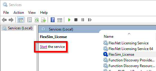

Start the service
While still in Windows Services Manager, use the Start link to start your new FlexSim_License service.
You should see a status bar showing the startup progress. The service usually starts in under a minute.
If there are any errors or other problems with starting the service, skip to the section Troubleshooting problems with the service.
