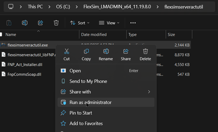

  1. Ben_WilsonADSK_2-1755634823871.pngIn your extracted download folder of FlexSim license server materials, navigate into the folder flexsimserveractutil.
  2. Right-click flexsimserveractutil.exe and select Run as administrator.
  3. 1670519038015.pngSelect the menu option Tools > Licensing Service > Install anchor service.
You should receive a confirmation that FlexNet Licensing Service 64 is now installed.
