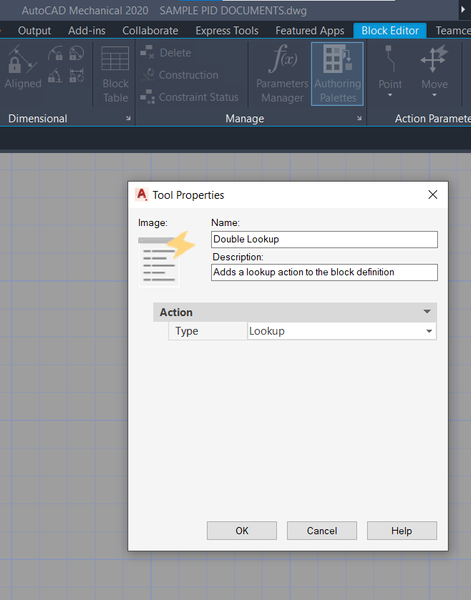

chris_blessing
in reply to: Libbya
Mechanical 2020 does not have an option to add a second lookup. Am I doing something wrong?
Message 7 of 30
Libbya
in reply to: chris_blessing
You are trying to create a tool from the lookup action instead of the lookup parameter.
Message 8 of 30
chris_blessing
in reply to: Libbya
@Libbya That would do it, thanks!
