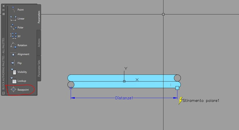

mmm,i check before saving the block if the hatch is associative,and it was.now works properly,thank you so much,you save my ass. if you also knew why the base point does not rotate despite having included it in the polar stretch you would be great.thanks
edit:can you explain how you had force the associative parameter in this file?thanks
Message 10 of 11
h_s_walker
See the three images attached. Add the BASEPOINT parameter to your block and then add it to your polar stretch and the basepoint will move. The other two images show you how to have a hatch be associative
