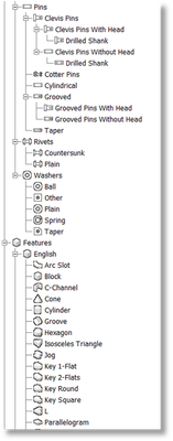

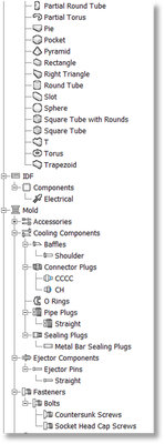

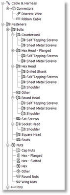

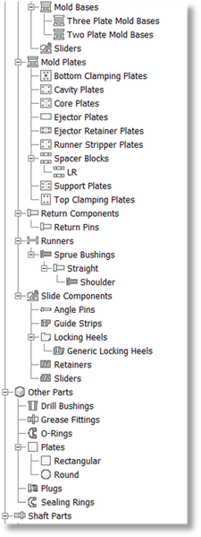

Notice all the types of components provided for you:
