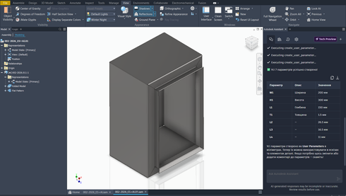

1. Create parameters in a blank part
At the first stage, a new part is created without geometry.
Instead of the classic creation of parameters through the Parameters window, AI Assistant is used. Parameters are set by text command and automatically added to the model.
This allows you to set the basic structure of the model much faster, especially when there are many parameters.
The following parameters were created:
  • W1 — width
  • H1 — height
  • L1 — depth
  • T1 — thickness
  • L2, L3, L4 — auxiliary
The key point is that AI works correctly with the Ukrainian language. This allows you to formulate commands naturally, without having to switch to English.
In fact, AI acts as a quick interface to create a parametric model base.
After creating the parameters, the basic geometry of the part is built using the specified values.
