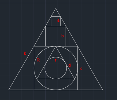

Problem 1:
Three squares of sides a, b, and c are inscribed on the equilateral triangle of side k.
On the square side c are inscribed two circles of radius R and r and an equilateral triangle of side d.
If a = 7.8179, find b, c, d, k, r, and r.
See figure in AutoCAD.
Solution:

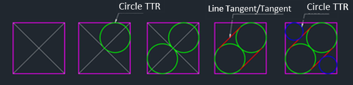

Problem 2
The third Sangaku in the lower right corner and is part of the plaque presented at Katayamahiko temple in October 1873.
Draw in Autocad and solve the question:
The figure shows a square ABCD with side 1 and center O. Circles O1 and O2 are equal and are inscribed on the square and tangent to O.
EF and E1F1 are common tangents to O1 and O2. X-ray circle O3 is tangent to AB, BC, and FE.
X-ray circle O4 is tangent to the HA, CD, and E1F1.
What is the X-ray value?
Solution:
