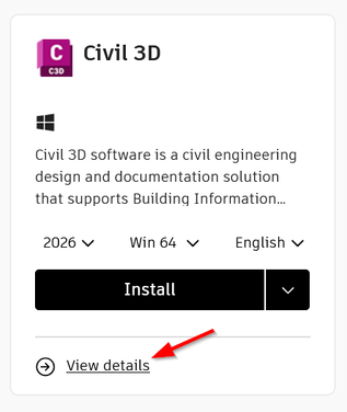

Where do I get it? Go to manage.autodesk.com in your browser. Once there, click on Products and Services. Now, scroll down to Civil 3D and click on View Details...
