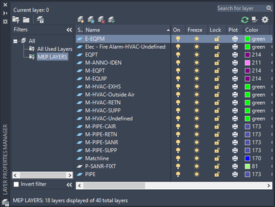

I recently had a request from one of my Civil Engineers – if Systems can be placed on separate layers/levels (water, sewer, fire protection, storm drain, elec, comms) for exports. On average, Revit does a good job of isolating disciplines and their settings. That said, have you ever had to export your Mechanical file to DWG?  Then tried turning off just the Supply Duct or Sanitary Pipe layer in the exported file. You can’t because All duct/Pipe are exported to the same layers (P-PIPE or M-HVAC-DUCT).
When exporting, Revit does not distinguish between the different Duct and Pipe systems. It exports based on elements Category. I have found this largely effects Duct, Pipe and Equipment in the Mechanical models the most.  I do see it occasionally in my Architecture and Interiors models. When both are in the same model, I want the Interiors layers to start with “I” and the Architectural layers to start with an “A”.  Layer Modifiers can help with this.

Other options I select and edit are the System Type, Phase Status & the 3 Custom options. Below are examples of the naming I used for each option.
  • System Type will be used to define the System designator of the layer
  • Phase Status will be sued to define the Phase Status of the layer
  • Custom options will be used for things that have no category.
    • I use them for the Center Line and Rise/Drop options of Pipe and Duct

The resulting layer made in the DWG for Duct Accessories will be something like this:
  • New Supply Duct Accessory, the layer would read M-HVAC-SUPP
  • Demo Supply Duct Accessory, the layer would read MD-HVAC-SUPP
  • Existing Supply Duct Accessory, the layer would read ME-HVAC-SUPP
Repeat these steps for each category that needs to export to a specific system. Modify them as needed to use the available modifiers that have been assigned. Not all categories need Modifiers, some work fine the way they are.
With an out of the box export all that would be exported would be M-HVAC-DUCT and M-PIPE. With the layer modifiers you get a more accurate representation of the elements in the model. For the few elements that do not export properly return to the export list and edit the modifier options to export them accurately.
